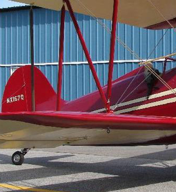

If built per plans, the tie down is located on the forward side of the front spar where the interplane struts attach.
The bottom wing plans don't really show the location.
Here's a shot of John Hanson's Hatz. You can see the tie down ring below the struts.
Re: Tie downs
The tie down hole location should be 2.900 inches outboard of the front interplane strut bolt hole and about 3/8 inch ahead of the front strut fitting plate. Drill a few 1/16 or smaller holes and feel for it. It should be 1/4-28 thread.
