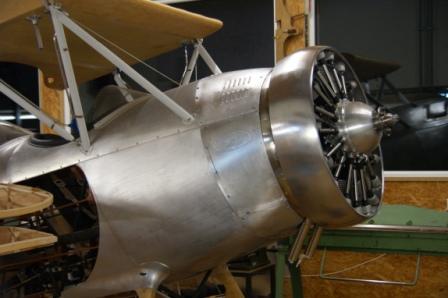

Here is a picture of our newly completed aluminum speedring for our Rotec powered Hatz! Enjoy! Best regards

ok, how much $$$ and where do I send the check?
Seriously, it looks fabulous! I can't wait to get to that stage myself.

Beautiful. Share some details on method of support to air frame. Price and availability?

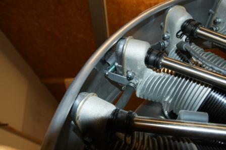

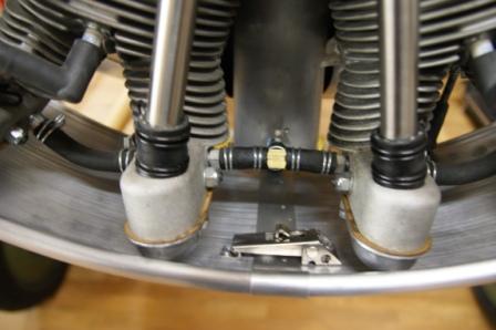

Hi all,
The manufacture of our speedring by spin forming is a time consuming and risky work, hence it is not a cheap part. Price has not been fixed yet, although it is above $1000.-. A mounting kit is available at extra cost as is the possibepolished finish (if it will not be painted). We have cut it apart and mounted it on 4 "elastic" positions and tighten it by means of a spanner (see pictures). This is pretty well about the way as the big Waco guys do it. As we are useing several wooden moulds we intend to run batches of orders of at least six rings in order to keep cost as low as possible. The nice thing is that the same ring (with differently positioned mounting positions) can be mounted on a 7-cy. Rotec as well.
Here are some detail views:

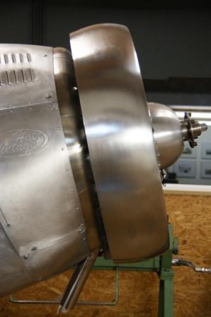

Hi Hatzers,
Speedring is smooth finished and wings are almost done. Our Hatz will be ready for cover next summer! Watch for updated website at www.aeroplaneworks.ch
