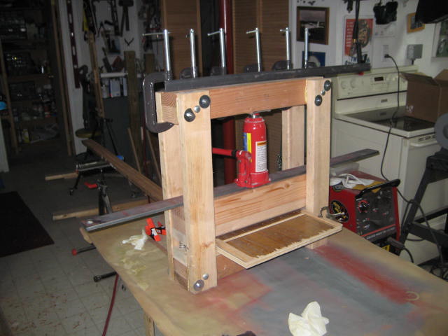

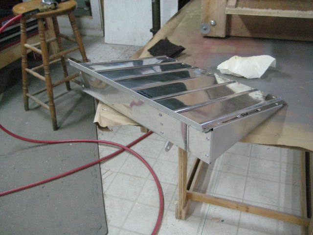

Before beginning the actual ailerons I made a short section of aileron (approx. 18") to practice the skills and make a few mistakes that won't show up in the final product. This act proved to be quite helpful as actual fabrication progressed.

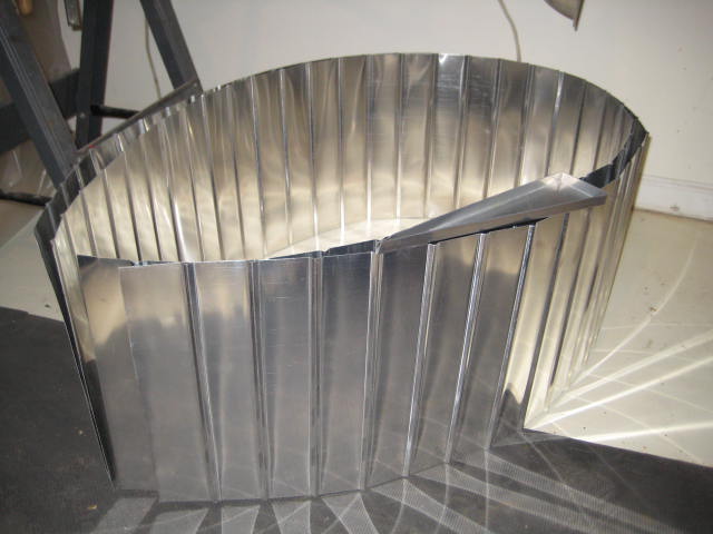

I built my own press according to the old EAA article and used .016" 2024T3 for the skins. The end caps and ribs are 3003-H14 ( a joy to work with) and instead of the wooden wedge trailing edge I am using Cessna trailing edge bulb. The trailing edge will have a nice finished look and less chance of people losing skin on the diamonds. The aileron spar is 032" 2024-T3 which is a bear to work with unless you have full scale tooling. I have a 30" combination press - break - roll and made the spar in two sections with a doubler. Once I determined the bend radius my press produced, the calculations were pretty straight forward. I know a couple of people with machine shops and large breaks but why let them have all the fun.
Back to the aileron press, I had to C-clamp a heavy piece of angle iron to the top of the press and install extra thru bolts at the corner joints. I used an 8 ton hydraulic jack for pressure and ran each skin through the press twice, reversing first end in, to neutralize any variation from the first pressing. If I were to do it again I'm pretty sure I'd save my pennies and find a source for the skins rather than press my own. I like the fact I made my own but I have a feeling mass produced skins would be more uniform.

- Short practice section of aileron.
- IMG_0009.JPG (50.81 KiB) Viewed 3611 times
- Aileron press with C-clamped angle iron.
- IMG_0008.JPG (54.67 KiB) Viewed 3611 times
- These skins are 16" x 96"x .016" with corrugations every 2" between peaks.
- IMG_0010.JPG (46.97 KiB) Viewed 3611 times

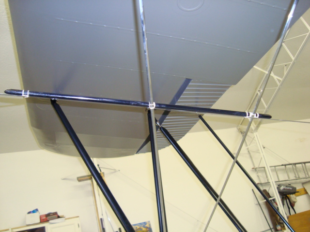

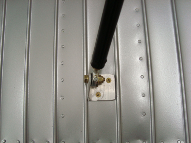

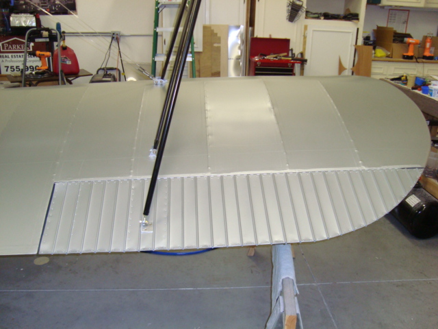

- Posts: 43
- Joined: Tue Nov 09, 2010 8:12 pm
Re: Aluminum Aileron questions

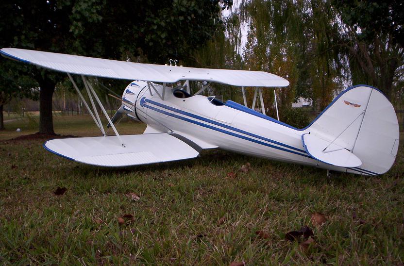

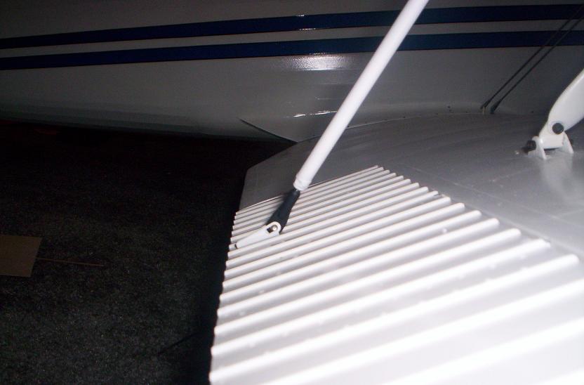

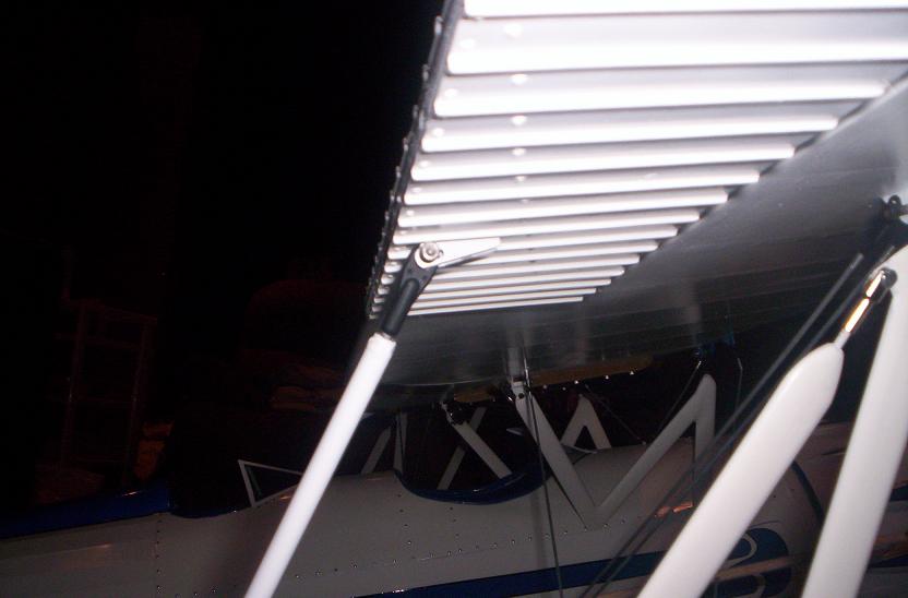

I had the same differential issue when setting up the aileron slave rods for my 25% scratch built Waco YMF-5. The Waco has a diffent type of flush mount bracket that traps the slave rod inbetween the bracket. The bracket on the top of the bottom aileron faces one direction and the brackt on the bottom of the top aileron faces the other. They are the same distance from the T/E of the aileron but the bracket direction corrects the differential. I set them up on my model the same as the full scale and the aileron differential issue was resolved. The bracket resembles a wing from a toggle bolt nut which is what I used on my model.
See the atatched pics of my model slave rod setup. As you can see I like classic bipes.
Anthony
Anthony
- Waco 299.jpg (45.77 KiB) Viewed 3587 times
- Waco 300.jpg (50.21 KiB) Viewed 3587 times
- Waco 308.jpg (105.72 KiB) Viewed 3587 times
