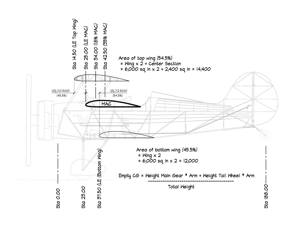

center of gravity location
Re: center of gravity location
I believe the test flying you'll do in the first 25 hours should answer most of the questions you have. I haven't attached my wings yet so can't help with the flying wires.
Weight Profile Small.png (129.67 KiB) Viewed 2447 times
