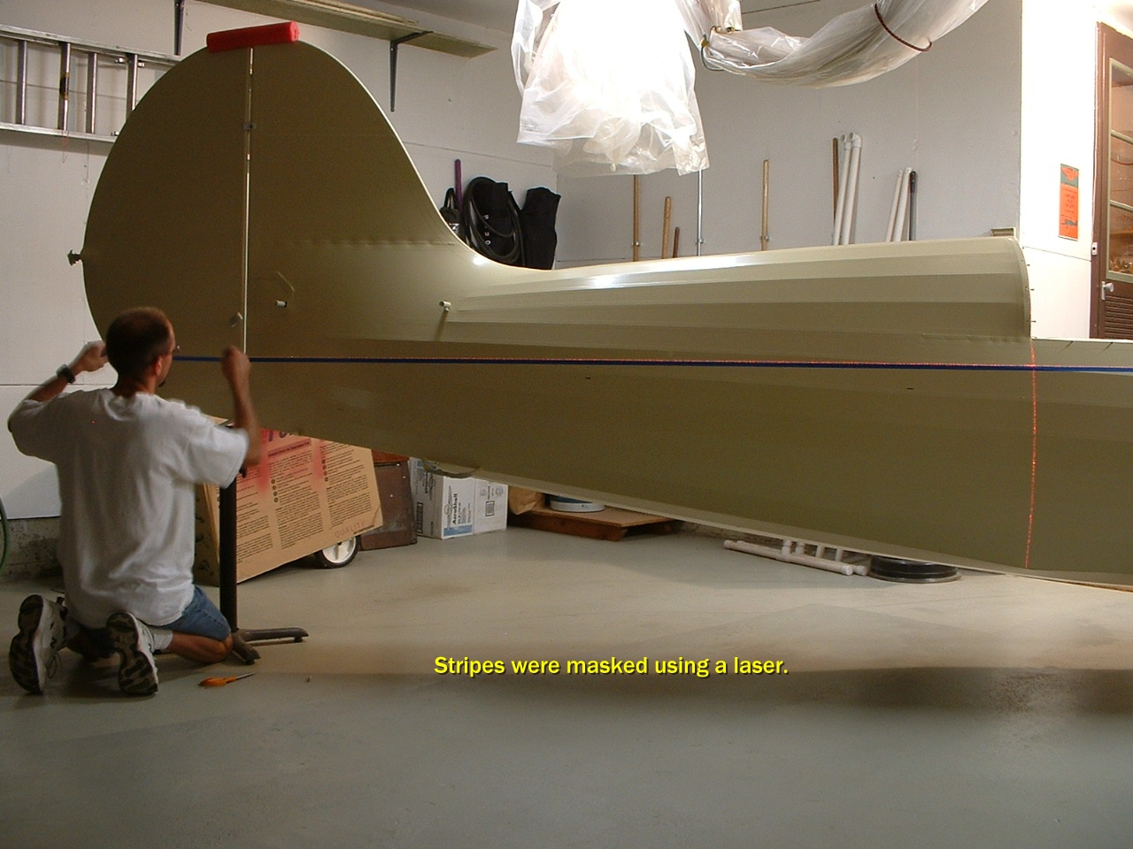

Hi Scott,
For anyone planning to paint stripes on the fuselage a laser is very useful. We wanted stripes but the stringers, being curved, made it confusing to lay out the masking in a straight line. I think the laser cost about $20.00 to $30.00 and I mounted it on a camera tri-pod.
- Fuselage114 08-03-07.jpg.JPG (345.14 KiB) Viewed 2954 times

John,
Great idea! Please, if you have more tips I'd like to hear about them.
