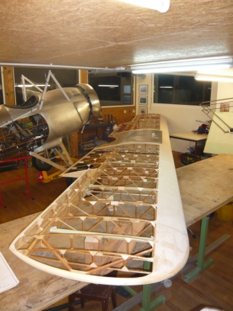

Hi Hatz folks,
As we posted earlier, we cold formed our drag/antidrag wires from stainless AISI 316 material be rolling the 10-32 threads and reduceing the wire between the threads by cold forming to a 1/8" square section. Thus we achieved a weight saving of about 33% compared to a full 3/16 rod with cut threads. Strength is tested and meet the AN 703 spec!
Due to a lenght error we have to remake some wires in the next 2 weeks and if somebody is interested, we can make some more. Lenght is 40" from clevis pin to pin, but can be made different if desired. Prices depend how many we can produce in a bulk (our model streamline wire machine has to be especially set up for that purpose, so we have to make those in a row). If anyone is interested, please send an email (see http://www.aeroplaneworks.ch)
By the way: We have now compleded the wook work on all wings and are now building the aluminum ailerons. See picture included!
Hope to meet you all at Brodhead this summer!
Best regards
Best regards
