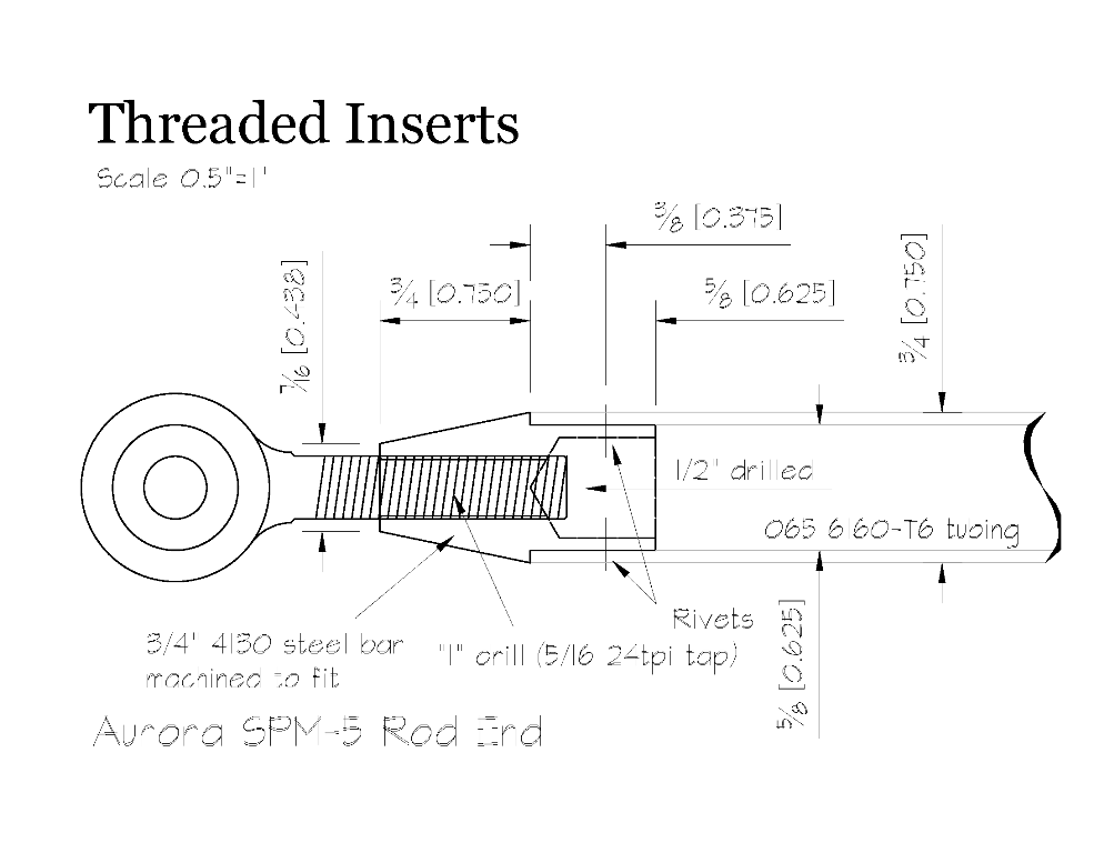

I spoke to the engineer next door today and he had some RV4 plans. We looked up the bell crank material. It's 063 2024-T3 aluminum. I check my Glasair and it's the same thickness. The Glasair plans don't mention the material as the bell cranks are pre made. So I think I'll use 063 2024-T3 aluminum to make the bell crank. I'm going to try and machine the parts on my CNC router.
The other thing he mentioned is that aluminum tubing can be substituted for the steel push rod tubing as long as the thickness is doubled. The RV4 has some push rod linkages made from 3/4" 035 6160-T6 that are 65" long. All of the Hatz push rods are less than 65". I'm going to make my push rods from 065 6160-T6 aluminum tubing. The weight is half that of steel even with double the wall thickness. The threaded rod end inserts are still made of 4130 steel rod, but are riveted to the aluminum tubing. Both the RV4 and the Glasair II use the same method.
Tube Inserts 0.75 6160 x 0.065.png (68.77 KiB) Viewed 3587 times

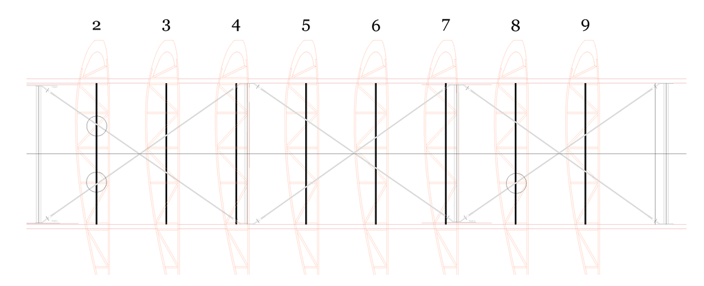

As always I analyze things to death. I had drawn up the drag/antidrag wires once before to get the lengths. I finally figured out how to draft the drag/antidrag wire conflicts with the ribs without a 3D model. The attached schematic predicts where the conflicts will be if the wing is built exactly to plan dimensions. On the schematic if the wire crosses the black line within the area of a rib cross member, there will be a conflict. I have circled the three possible conflicts on the bottom wing. When I trial fit the wing together, I thought there were only two. And there may only be two depending on how close I am to plan dimensions with my construction.
