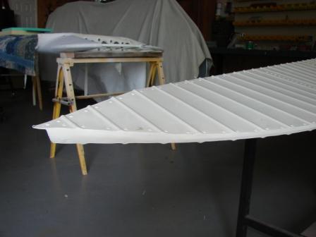

On to another question. The plans have a hardwood strip between the top and bottom skins up until the aileron curves toward the tip, at which point the wood is discontinued and the skins are riveted together with an aluminum strip between. But since there is no longer a gap between the skins (there's a 1/8" gap made by the hardwood) the skins will have to squeeze together to fill the gap. It seems there'd be a triangular gap left in the trailing edge just outboard of the hardwood strip. The trailing edge would be thicker where the wood is, than where it isn't. I hope that description makes sense. Does anyone have any photos of the the trailing edge of their aluminum ailerons to see how it turned out?

I ran my ailerons out to the wing tip. I did not like the thin edge look at the wing bow. So I used a narrow and thin (.090) aluminum spacer between the skins and when I got to the end I formed a wider spacer that matched the wing bow shape and ran this to the hinge. A lot of work - but a great look at the wing bow.
N838MM
N838MM
