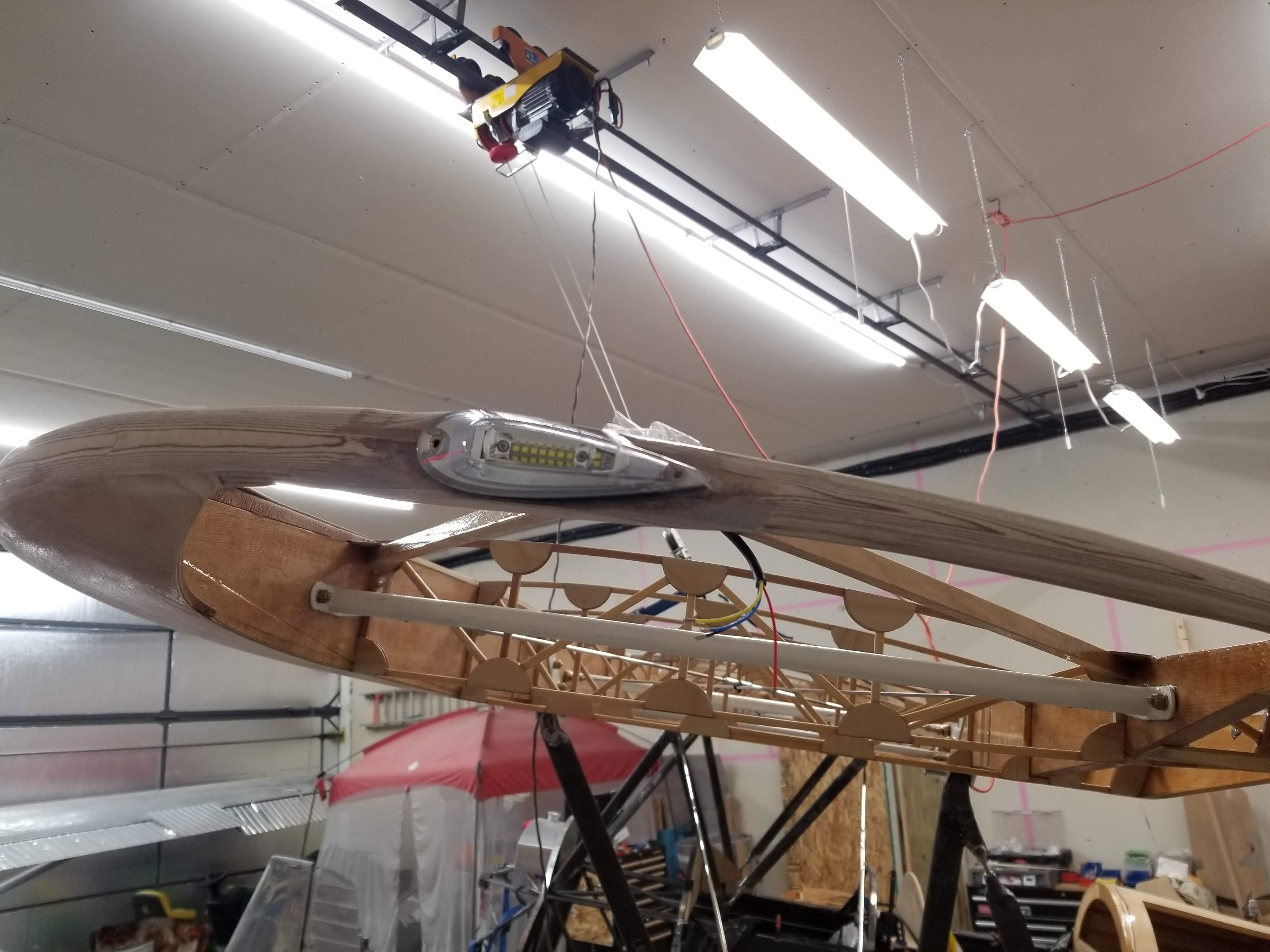

2: I have the Baja lights like used on the RV builds and need some advice on mounting brackets/clear covers. The airfoil is slightly different on the RVs but I think the lens can be slightly modified. I'm planning on a single light each bottom wing between a rib and false rib. I have routered out reinforcement pieces to the rib ends, but still haven't made the skin leading edge cuts yet. My question is: Is there a preferred mounting kit/lens kit/combo that is preferred for the Clark Y airfoil?

Ok no replies on this one so assuming the fiberglass turtle deck is no longer available. Update, Landing lights are from Baja designs and I found a blank install kit for the rv6 AT Duckworksae.com..... Using the space between a rib and false rib, I am able to insert 2 support false rib pieces to add strength and cut the one install bracket from kit, to make both light mounts. With a little heat, the lens bends well to fit the Clark Y shape. It has to be cut down about 1.5" to fit, but it rides perfect on the support ribs i made. P.S. if you plan on adding nav lights, you can 3D print a mount to epoxy on the wingtip top wings It works out very clean. If I ever figure out how to upload pics on here, ill do so on some of these items

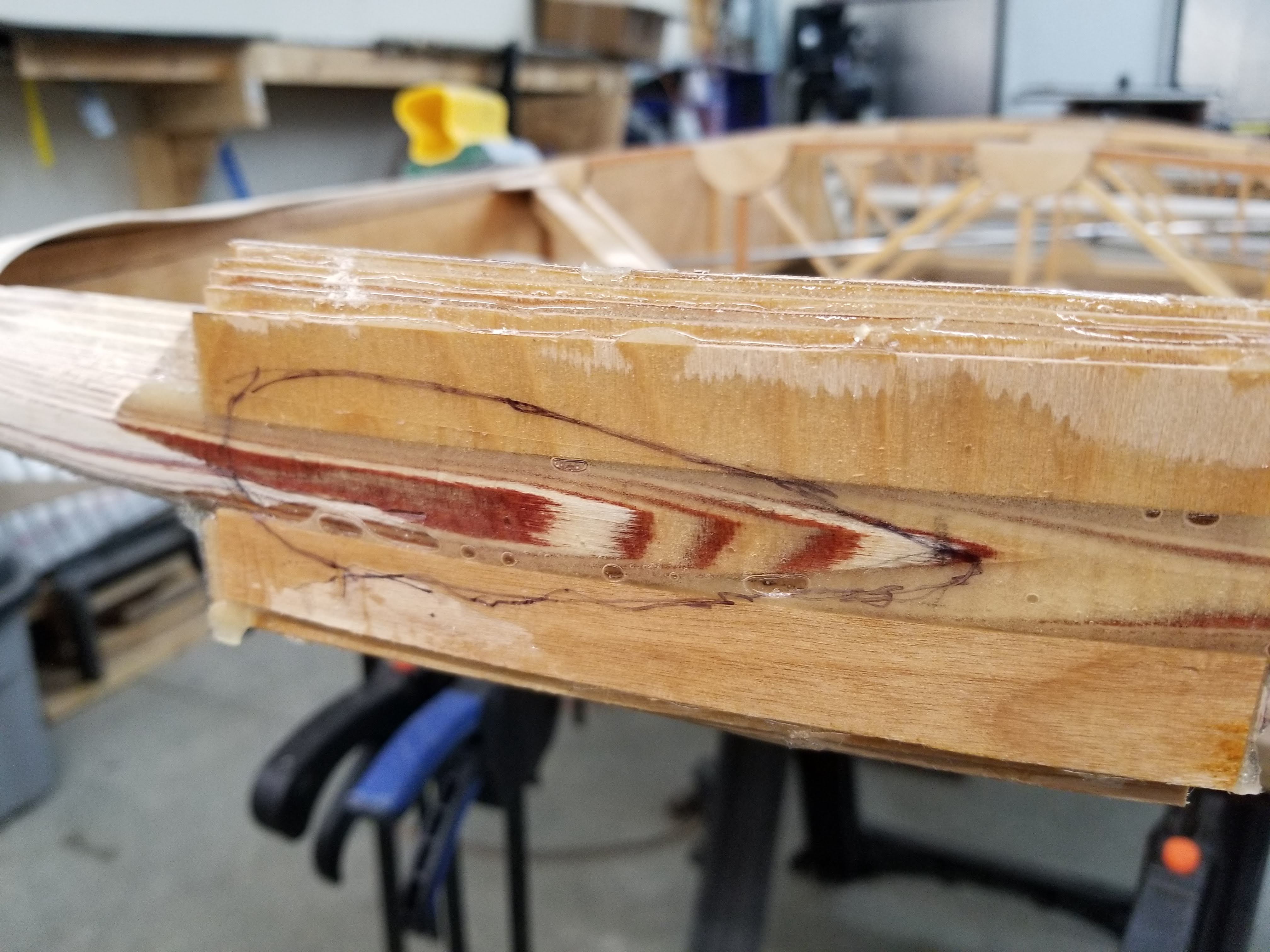

I left a flat spot on the bow for the NAV/Strobe light but it wasn't a big enough area. I added some wood to the bow and reshaped it so the light fit. I added a lot of wood but cut most of it away. There is just a slight bulge in the bow to fit the light.

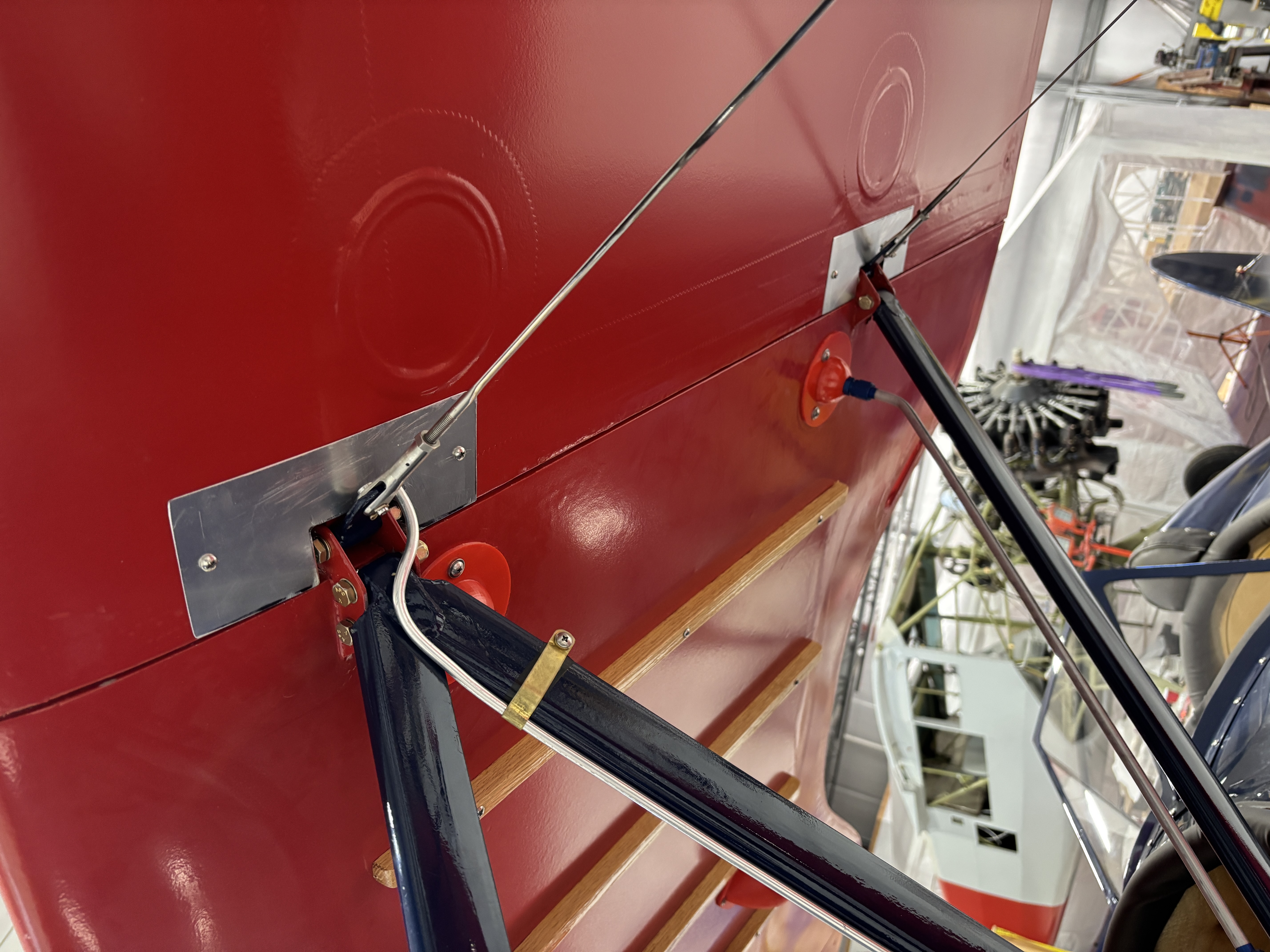

One of the problems is getting the wiring for the lights down the cabanes. I think I'm going to add some 3/8" aluminum tubing to match the fuel lines and run the wiring down it. I seen that on other builds.

Building the honey comb up on the bow is how i started to make my nav light mount. A friend happened to come by to see how the project was going and when he saw what i was working on. he offered to 3D print mounts. being the lazy guy I am, i jumped on this to save some time. I was very impressed with the fit on the first attempt.

mmarien wrote: Thu Dec 26, 2024 11:23 am One of the problems is getting the wiring for the lights down the cabanes. I think I'm going to add some 3/8" aluminum tubing to match the fuel lines and run the wiring down it. I seen that on other builds.
That was my plan, 3/8 tubing held to the struts with Adel clamps. I bought the tubing, wires, connectors, everything, but sold the plane. Still have all the parts including the lights and wires for sale if anybody's interested.

I ran my wires through some plastic air line so if needed they could be removed. The air line is mounted to the ribs but the wires are loose inside. I ran them down the cabane strut in some aluminum tubing. picture attached. Covers for the fuel lines were 3D printed.
