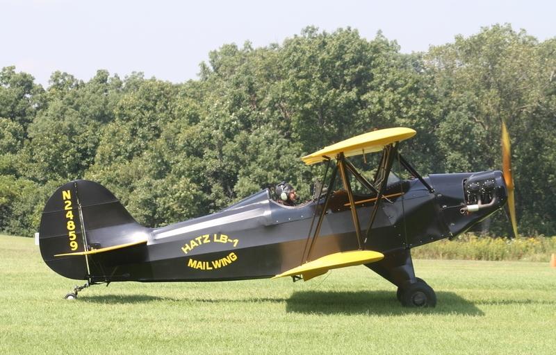

As close to the clusters as I could get, with a generous radius, and I didn't have any issues.
Attached is a picture of me at Blakesburg a couple of years ago. You can see a line behind my head where the cockpit aluminum meets the fabric. The top cross tube/cluster is right there and the bottom is where the plans have you locate it... remembering the LB/CB-1's have a more flat side than the Classics.

Thanks Jeff. that helps. I've emailed a couple folks of line as well... I'm starting to feel more comfortable with moving ahead on this.
