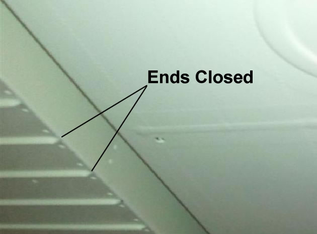

Hi folks,
Attached is a grainy picture of Ron Sieck's Hatz Classic aileron. You can see that the ends of the corrugations are closed. Ron told me he did this with a V notching cutter and something about a bolt. Even after Ron's explanation, I still can't quite visualize how it's done. Can someone please explain the process -- hopefully in pictures.

Re: Closing ends of aileron corrugations
Thanks for the info Ron. Ron Sieck wrote me yesterday and said he'll be sending a drawing to show how to close the ends. He also said the V notcher used is the N1 Hand Notcher from Aircraft Tool Supply Company. I'll post photos of how it's done when I get to this step.

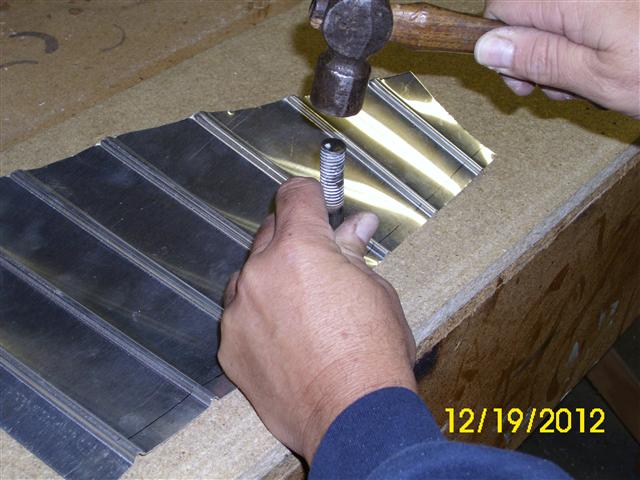

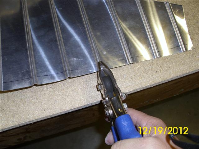

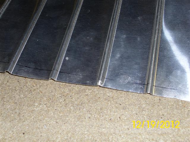

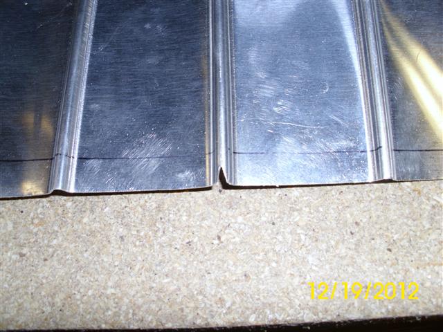

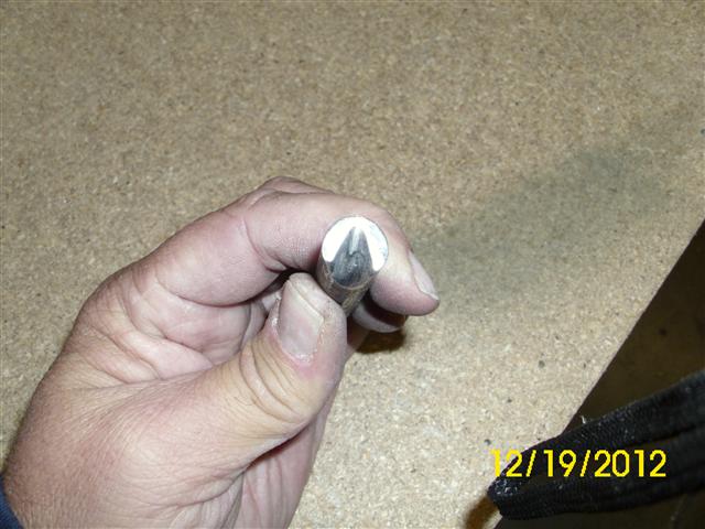

With guidance from Ron Sieck, I completed my first aileron. I thought I'd share with you how to close the corrugation ends. Attached below are pictures that will give you a pictorial how-to.
The only tools needed are the V notcher ($42), a hardware store 1/2" bolt to make a tool to close the notch and a small hammer.

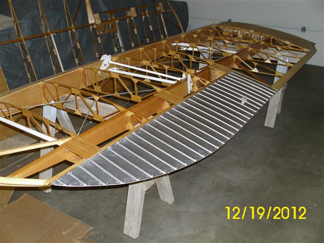

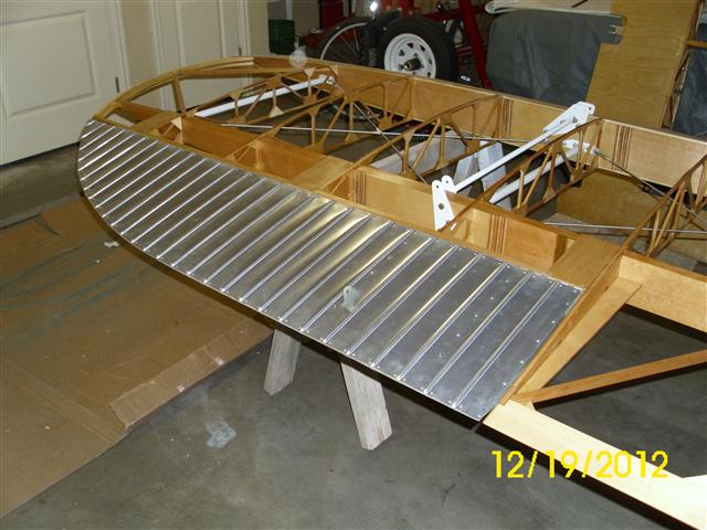

Finished aileron...
