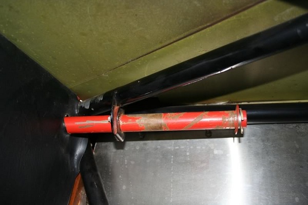

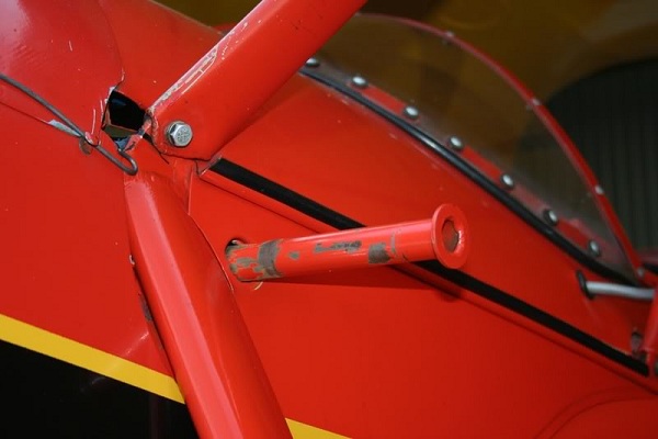

I plan on installing steps on the landing gear and a retractable/sliding step higher up on the firewall similar to the Waco. After doing that I'll see how the reach looks and figure out where I want the fuel filler. My biggest concern is being able to fuel the plane anywhere I go without having to rely on a ladder. I know you can make it work from the cockpit, but that really isn't my preferred choice.
If you take a look at this video from Rare Aircraft you can see how the step works. He explains the step at 7:10 on the video.
http://www.youtube.com/watch?v=h0VyCXceG6w
Here's a couple pics from an RNF to see how it is attached.

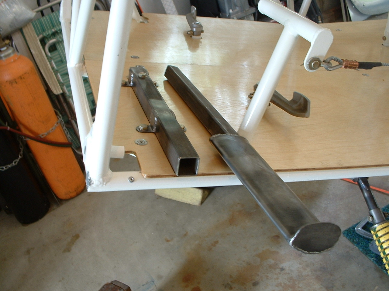

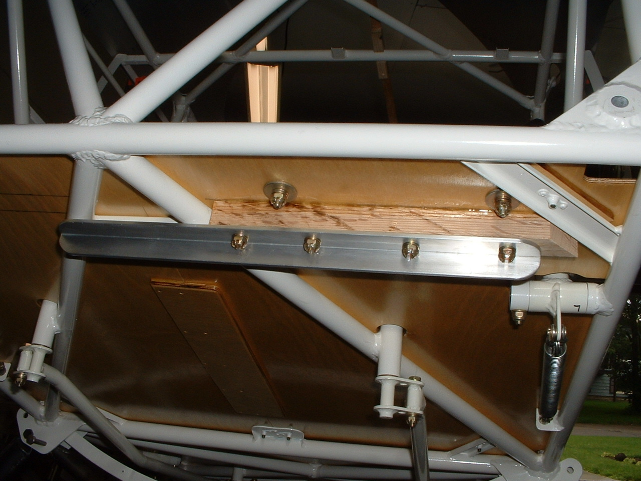

Re: New Fuel Tank
Here are some photos of the removable step. The Waco RNF step design would also be good.
John Hanson HC-012
Step06 07-09-04.jpg (347.85 KiB) Viewed 3698 times
Step07 07-09-04.jpg (350.54 KiB) Viewed 3698 times
