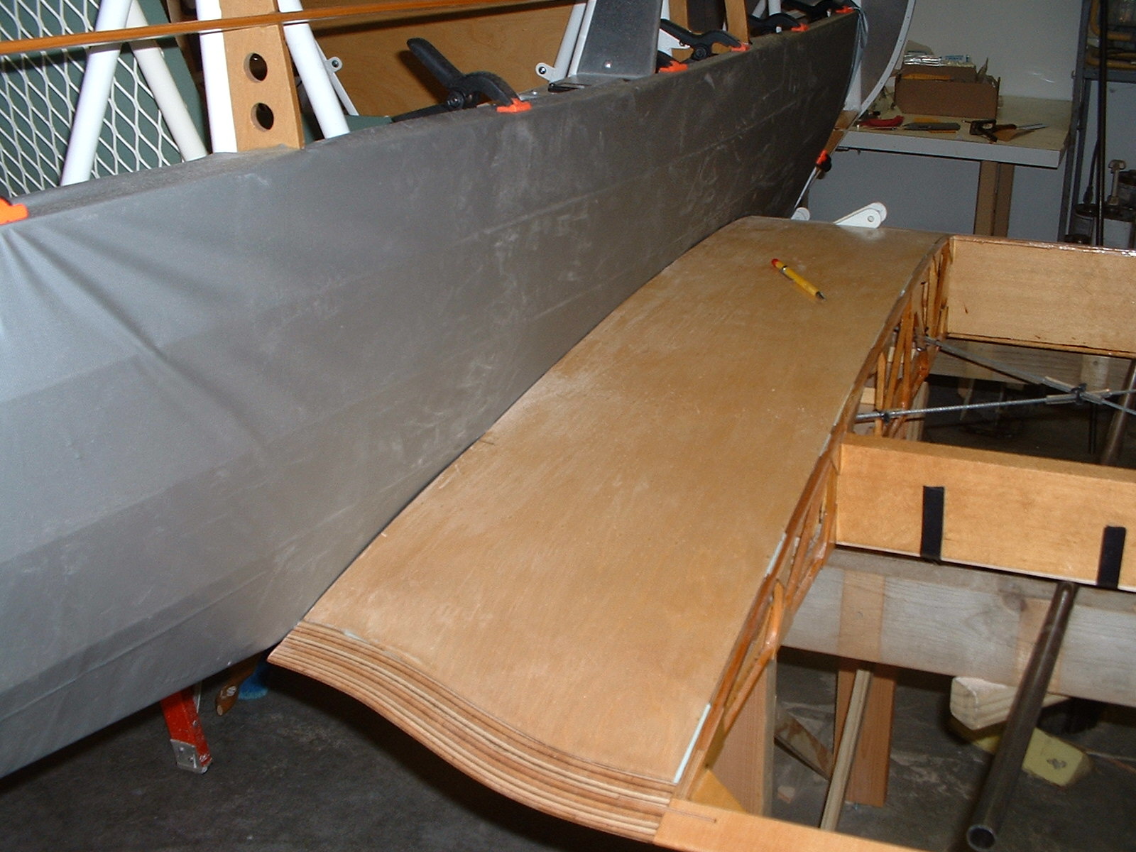

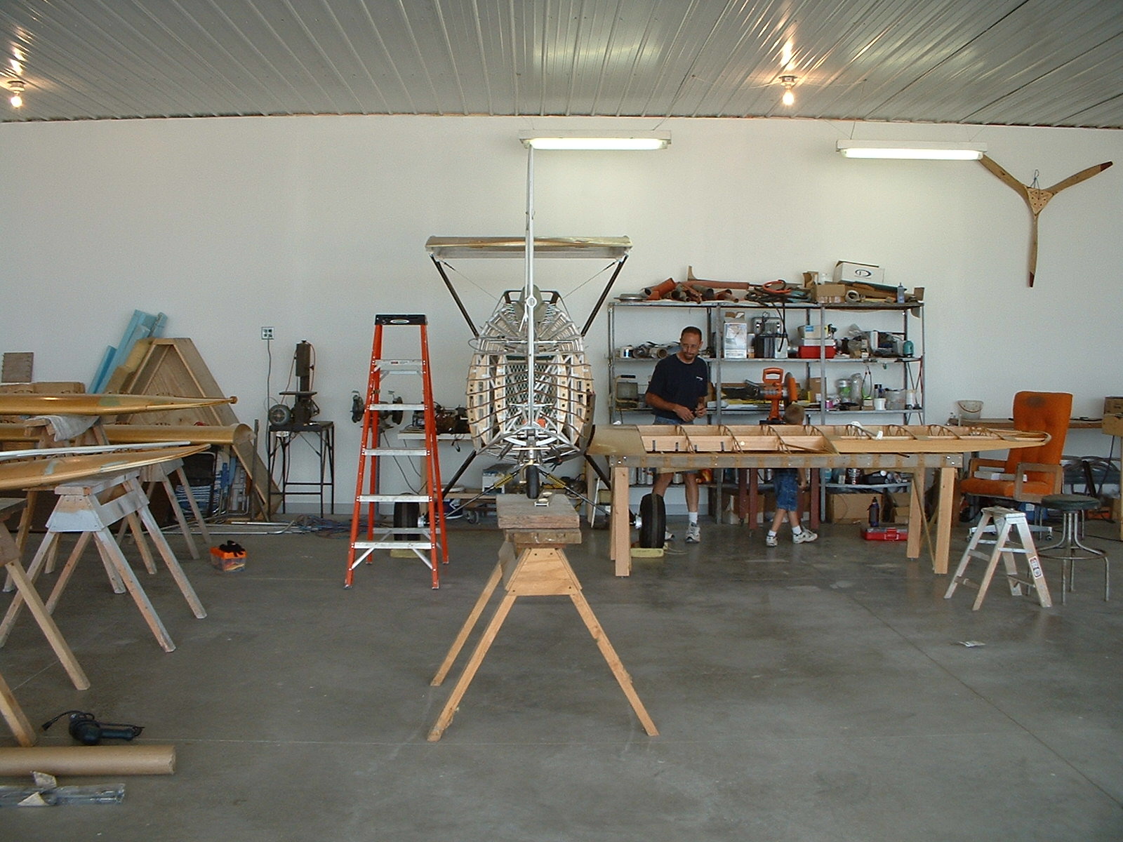

We made a cardboard template for the wing walk and allowed for about 1 inch of overhang of the root rib. Then we leveled the fuselage (with stringers on) and built a rack to lay the wing on with a couple pieces of tubing under the spars so we could roll it in and out from the fuselage. We stretched some plastic sheet over the stringers in the wing root area, positioned the wing 3 or 4 inches from the fuselage, and took measurements from the plastic to the wing walk and drew a line on the wing walk. From then on it was just a cut and fit operation with a saws-all and a hand held drum sander. I can see why there is no dimension in the plans
because every plane would be slightly different in that area.
- Rigging03 08-14-05.jpg (559.99 KiB) Viewed 3384 times
- Rigging08 08-14-05.jpg (507.4 KiB) Viewed 3384 times

My build picture looks nearly the same as John's I even have that same pencil. Plywood top and bottom from the aft edge of the leading edge skin and bordering the inside of the trailing edge. I made kraft paper patterns for all four panels. Traced the patterns onto plywood then epoxy glued and nailed the plywood on. I clamped a piece of visqueen to the fuselage side an shaved the inboard edge of the wing walk until I got a tight fit. The bottom plywood needed very little trimming. The wing walk ply ended up being trimmed, in places, quite close to the end compression rib.
