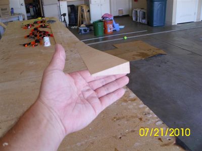

When I built the top right wing, I rough cut the trailing edge wood stock on my bandsaw then hand-planed and sanded it to final form. This took a lot of time. To make the other 3 trailing edge pieces, I used my portable planer. I produced 3 perfect trailing edges in just a few minutes. See more at my new construction photo gallery http://www.thehatz.com.
Making Wood Trailing Edge
- splischke
- Posts: 115
- DSCI0107.JPG (30.89 KiB) Viewed 3626 times

Re: Making Wood Trailing Edge
Oppps. I just learned that the redirect didn't work on some browsers. The URL http://www.thehatz.com should work now.
