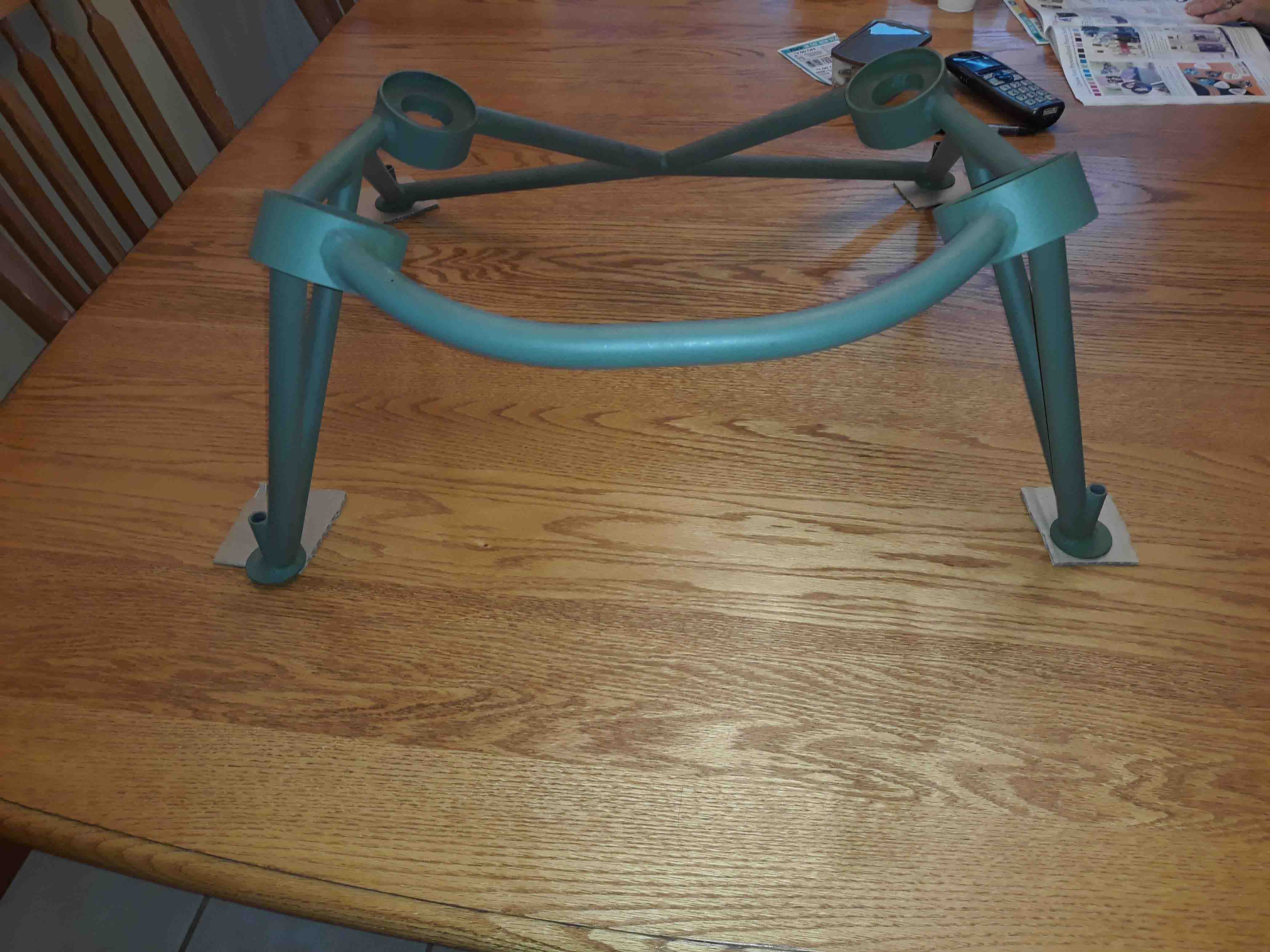

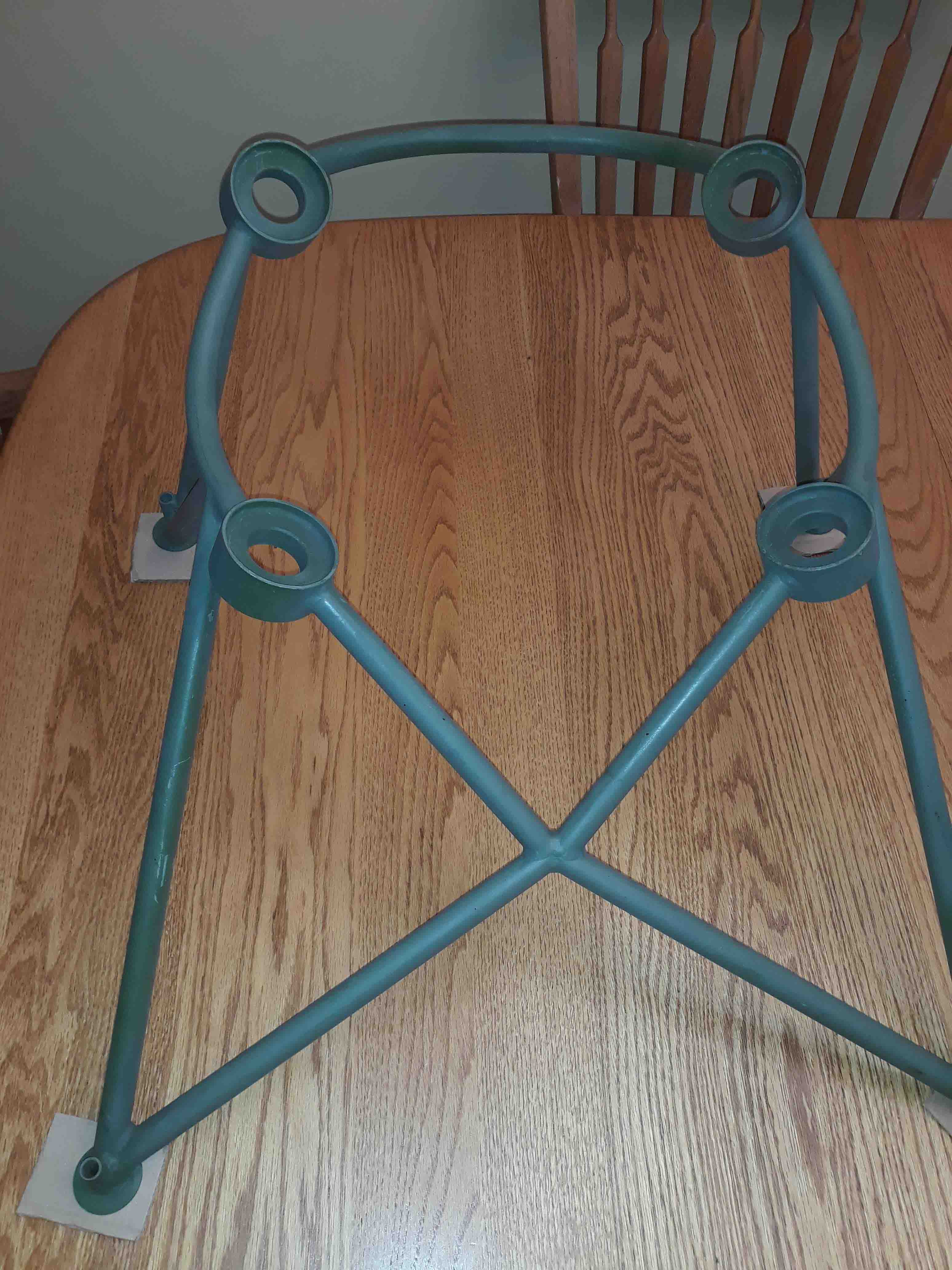

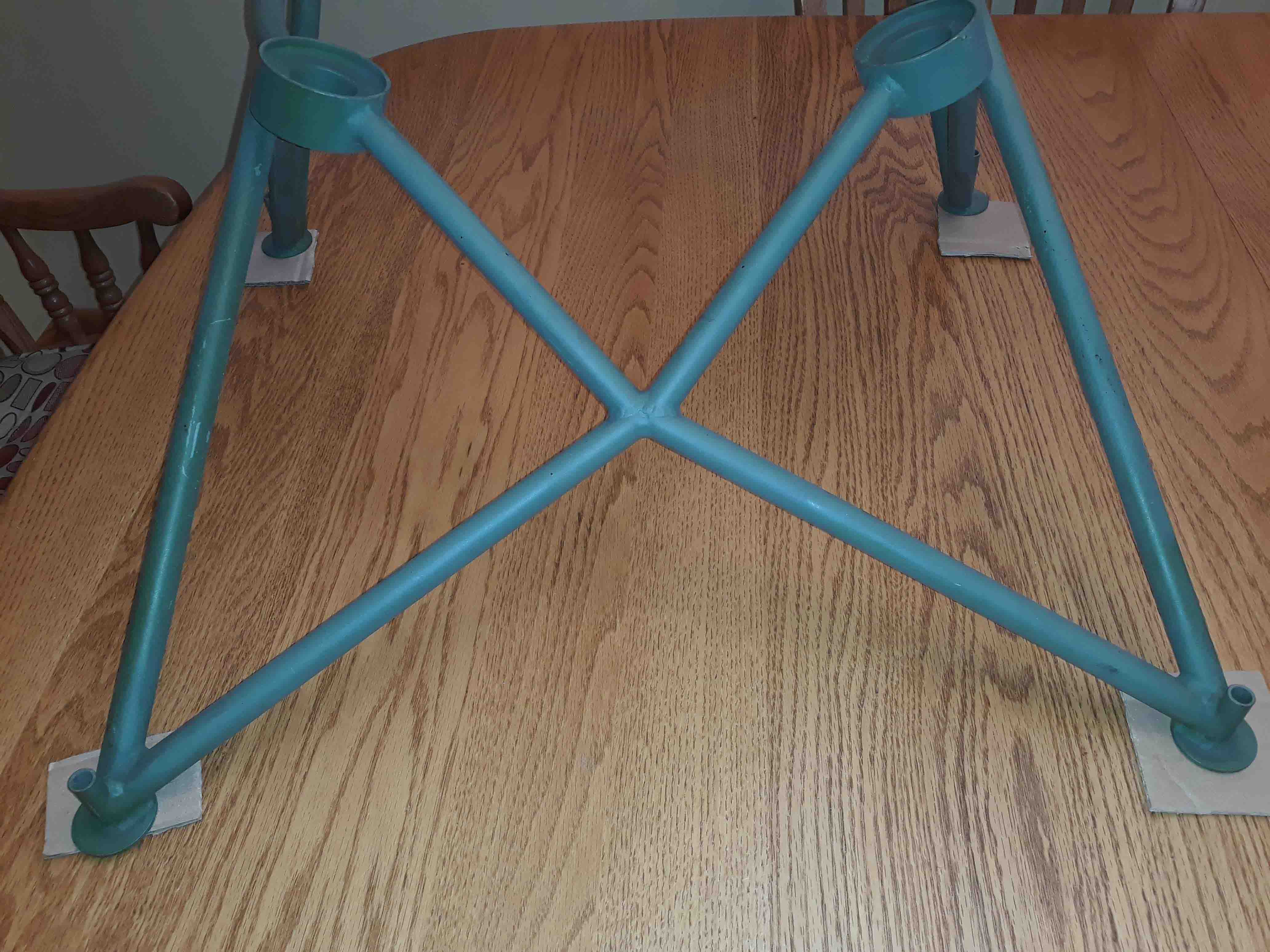

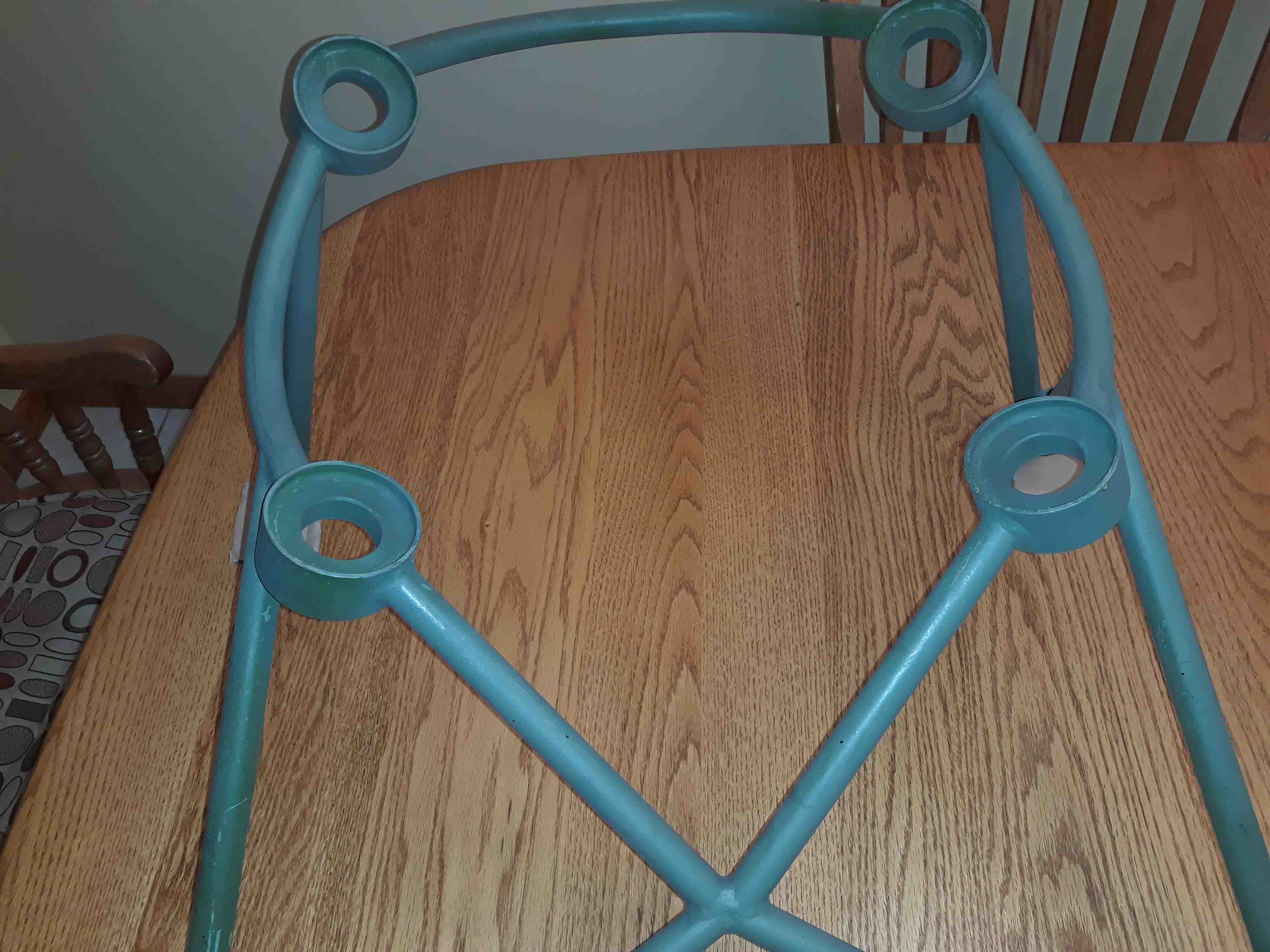

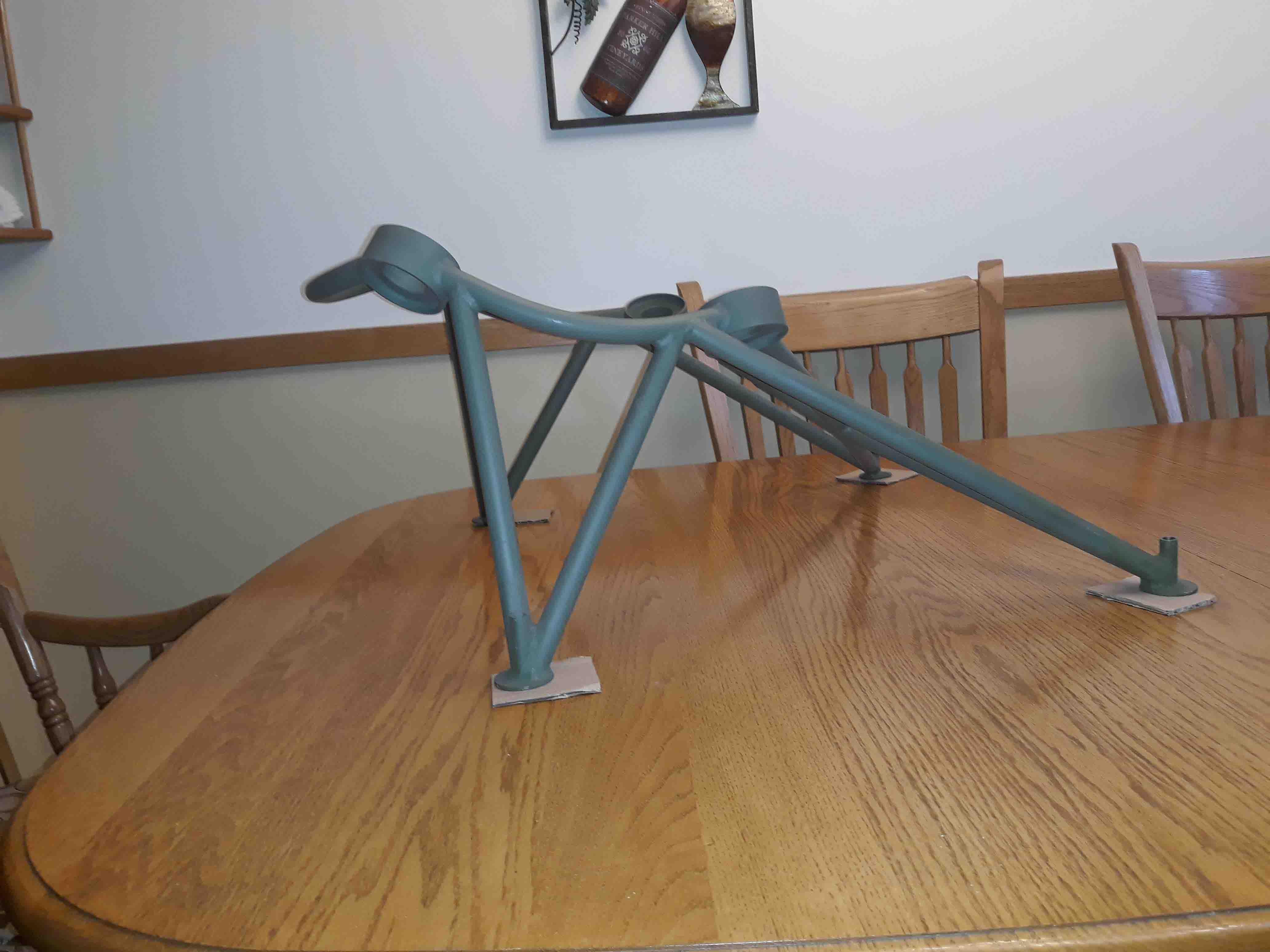

Hi Ray,
I took some pictures of my mount. I assume you have the plans drawing. This mount is very similar except for the dynafocal ring. As long as you keep the thrust line in the same place you should be fine. If you did not lengthen the fuselage you may want the engine closer to the firewall. There appears to be no down or right thrust built in.

Re: Dynafocal Engine Mount blue print----Still looking
Thanks Al, That helped a bunch. By the way, that is a dynafocal mount verses the conical mount. My plans show the thrust line 2 inches below the top of the top longeron. I'm using the H engine and that 2"s will not set the top of the engine low enough in the cowl. I'll have to lower it 1 or 2 inches. Didn't lengthen fuselage so will move as close to firewall as practical. Ray
