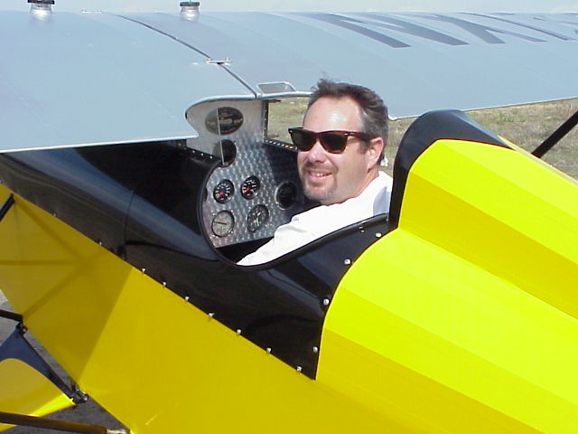

When I wanted to put an engine turned finish on the instrument panel of the Corben Super Ace I built several years ago, I purchased a kit from Eastwood. http://search.eastwood.com/search?p=KK& ... 20Kit&rk=1
It's a time consuming process, depending on the size and spacing you decide on. If you have access to a mill it's much easier to keep the spacing even, otherwise you can use a drillpress with a fence to keep the work straight. Just be careful with your spacing. The Eastwood kit uses a hard rubber rod and mandrel and requires very little abrasive.
If you're going to finish a panel that will have a bunch of holes in it, it's a lot easier to engine turn the rough panel before you drill or punch all your holes. The tool has a tougher time right on an edge.
Have fun,
Have fun,

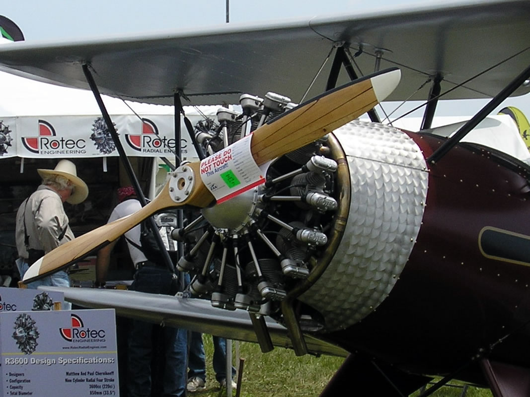

I believe I posted my method for the Hatz Classic a year ago. But for the cowl a low abrasive 3M 2"disc in a drill press was used. Prior to final assembly a grid was marked on 1" centers. The turning begins at the bottom rear point to insure that the lay of the turns overlap like fish scales. Each suffering turn overlaps the one blow and the row behind. The EAA Hints for home builders has a slightly different approach but feel mine had a some preference for me. There were a half dozen or so beyond the reach of the drill press but with care and slow speed turns were successfully applied to the clamped cowling pieces

This picture goes more to the finished product than the process but reflects that a fairly complex cowl can be "turned" if each step is undertaken in the right order. There were a couple of starts and restarts when doing this projec
