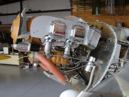

How about a scratch built 0-360?
Do you want to see a first run video - Go to my face book - Michael McGrew
N838MM

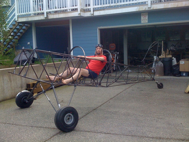

Thanks very much, gents, for the detailed responses. That sure helps.
BTW, I finally have my Hatz up on her wheels! Sitting in that pilot seat the first time was a thrill!!
