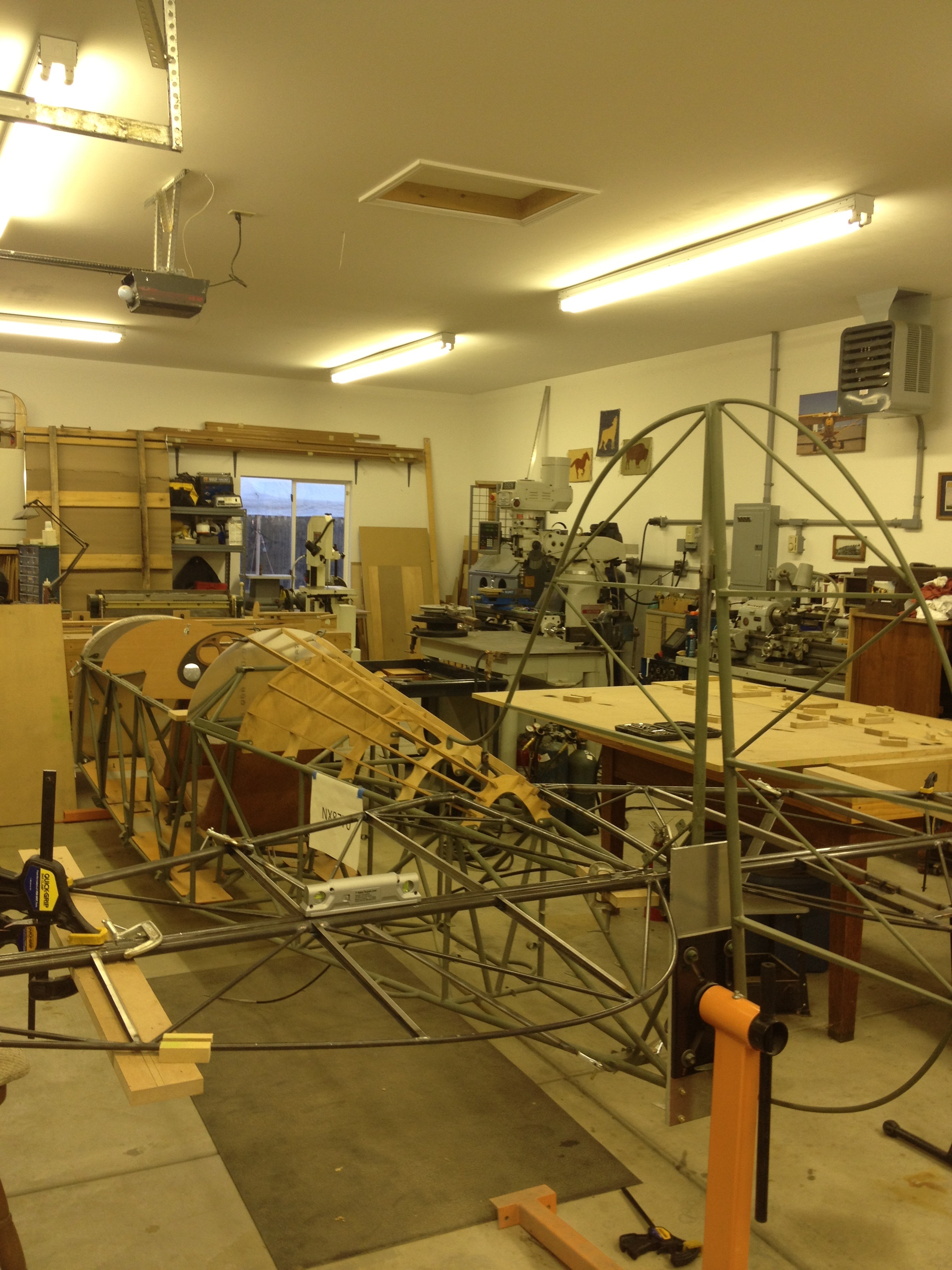

Thank you Al. What a pleasure and privilege hearing from you. I appreciate your thoughtfulness in answering. My tail is rounded now, like the 3 view on the cover of the plans. I like it. Paul Uhlig
Re: Elevator shape
Paul,
You're making good progress. Nice looking project!
