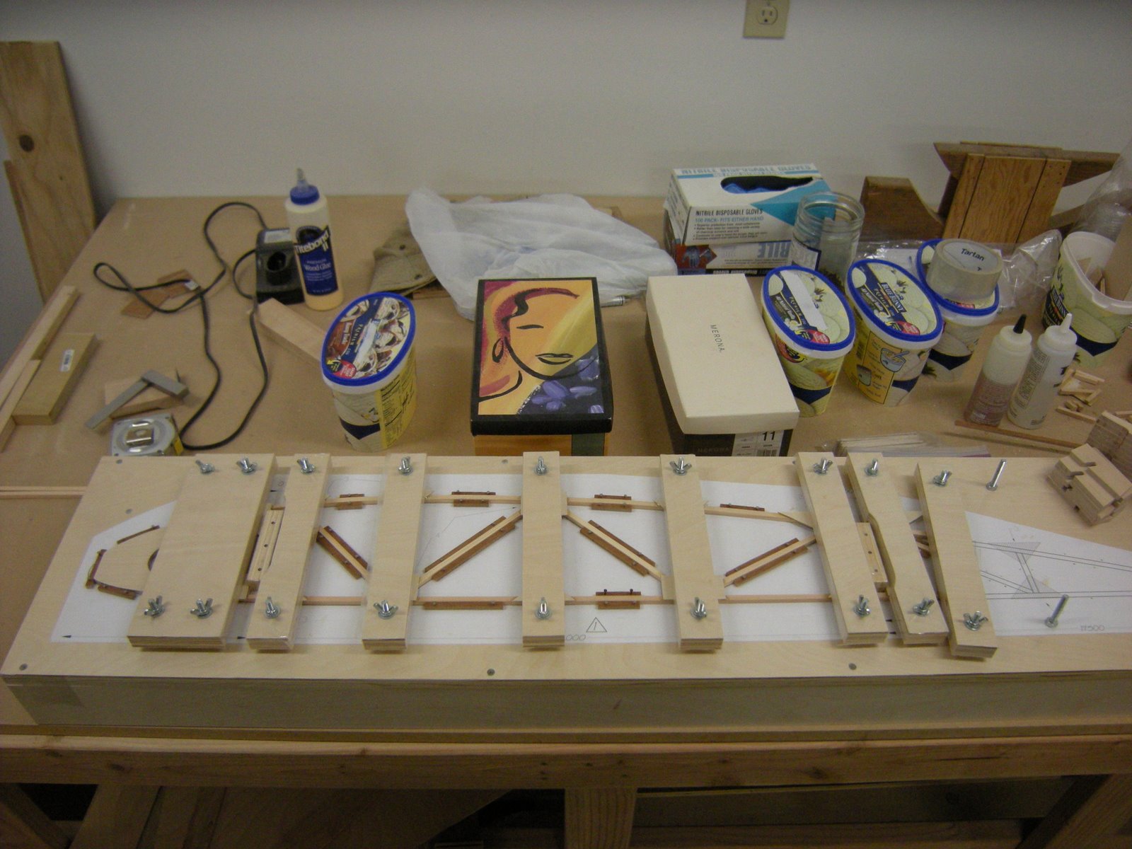

Re: Epoxy Clamping pressure
I have another method that worked for me:
A plywood board with the plans glued onto it, and long screws protruding from the bottom. Narrow pieces of plywood with holes to fit the screws. then I used wing nuts to adjust the clamping pressure. here's that 1000 word picture:
- another rib jig
