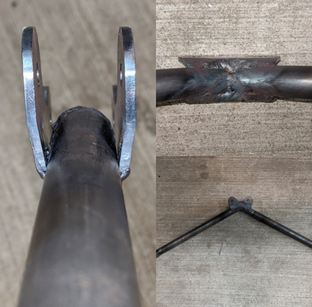

Re: Lower Cabane Vee
Five years later, here are some photos of the complete sub assembly.
You can see the slight bend inwards required for the welding.

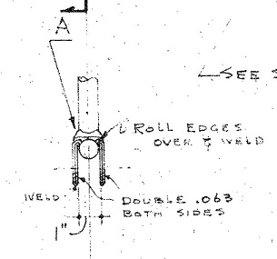

From my CB-1 plans.... I thought it too difficult to roll the edges and you see from above what I ran into.
Jim Wright found the same issue and he put a tube-in-a-tube in the first couple of inches of the top of the strut.
