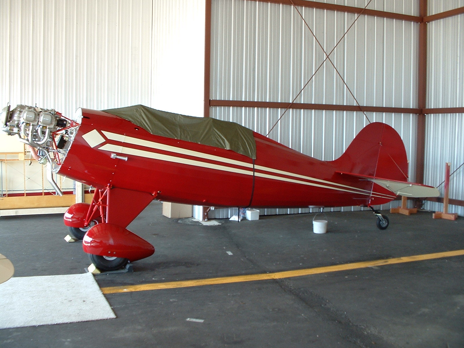

Hi Mike,
I made a paper pattern of the front windshield and a rectangular piece that would cover both cockpits. I purchased an inexpensive boat cover for material, some heavy snaps, a few feet of 1 inch webbing and a plastic clip like the ones on life jackets and back packs. With that in hand I gave it to my wife and she sewed it together. It goes on and off in about 30 seconds.
- Cockpit Cover05 07-30-08.jpg.JPG (385.17 KiB) Viewed 3338 times
