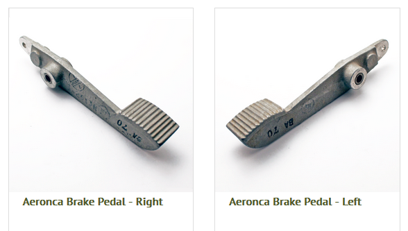

Thanks John. Just to clarify, that's 8 bushings yes?
The attached image looks like the right pedals to me, how about you?
Thanks for the help.

- Posts: 96
Re: Brake pedals
Order a couple extra bushings.
Those are the correct pedals.
John
John
