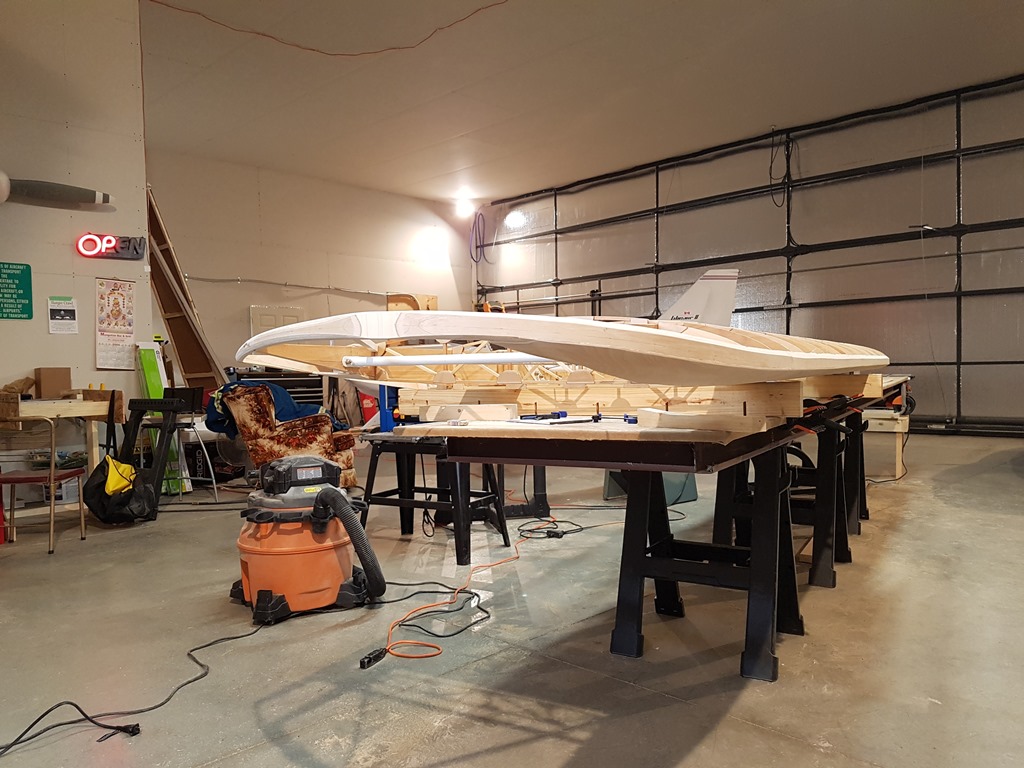

Redesigned wing bow. Flat spot is for NAV light.
Posts: 203
Re: Spar Tapers and Rib #10
Wow! That looks beautiful. Looks like you have a great place to work also.
Thanks. I'm pretty happy with the redesign of the bow so thought I would show it off. Long story about the big hanger. They were built for amphibs. 14 foot ceilings. My little Glasair looks lost in a corner. Not what I was looking for but definitely happy with it now that I started my build. Lots of working room for sure. It's heated with solar so gets a little chilly for a month or so in the winter.
